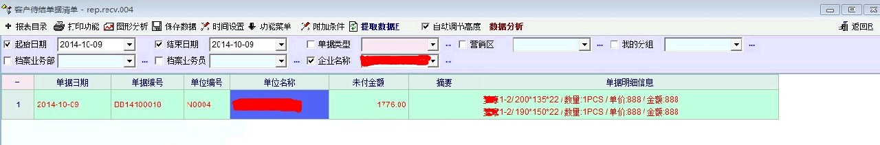

jazzwall  [个人空间]
注册  2013-12-27
发贴数  82
#5»发布于2014-10-31 15:25
int show_row_ext()
 int i,id
 string sql,vr_note
 sql="select count(*) from ebs_vr_item where voucher_id=(select voucher_id from ebs_v where voucher_no='"+voucher_no+"')"
 db_run(sql)
 id=db_res(0)
 //msg(id)
 vr_note=""
 for(i=1;i<=id;i++)
 sql="select b.res_name&'/ '&b.res_spec,a.std_num,a.std_unit_type_id,a.inp_price/100,a.total_amount/100 from ebs_vr_item a,res b,ebs_v c where a.res_id=b.res_id"
 sql=sql+" and a.item_id="+i+" and a.voucher_id=c.voucher_id and c.voucher_no='"+voucher_no+"'"
 db_run(sql)
 db_map("res_unit_type","std_unit_type_id","std_unit_type_id")
 vr_note=vr_note+nl()+" "+db_res(0)+" / 数量:"+db_res(1)+db_res(2)+" / 单价:"+db_res(3)+" / 金额:"+db_res(4)
 grid_set_v("MG","djmx",change_row_id,vr_note)
  //change_row_id 表示当前行
之前用在客户待结单据清单的,给你参考一下,djmx是自定义的明细属性
截图1
        于 2014-10-31 15:25 被 jazzwall 修改
